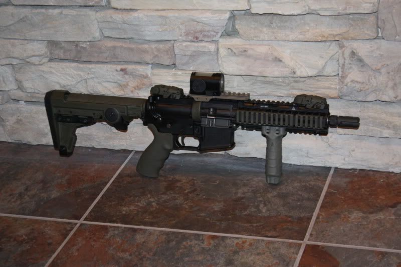

Here is my 7" with a Vortex FH. Im getting ready to pull the trigger on a can for it. I love the size and how it handles. It's a great gun to shoot.
