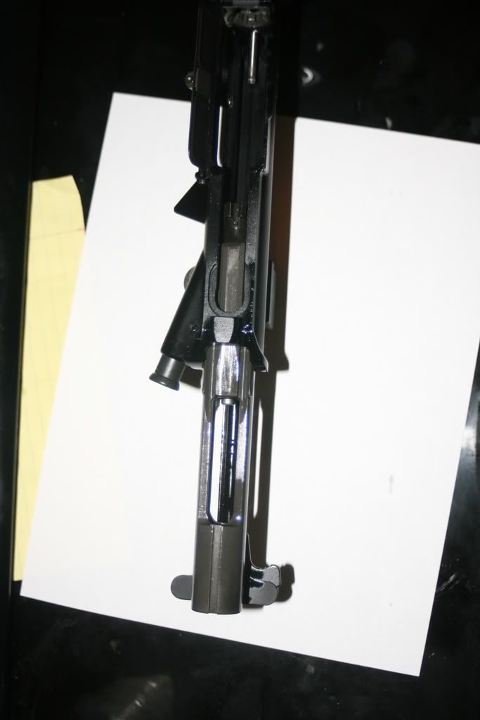

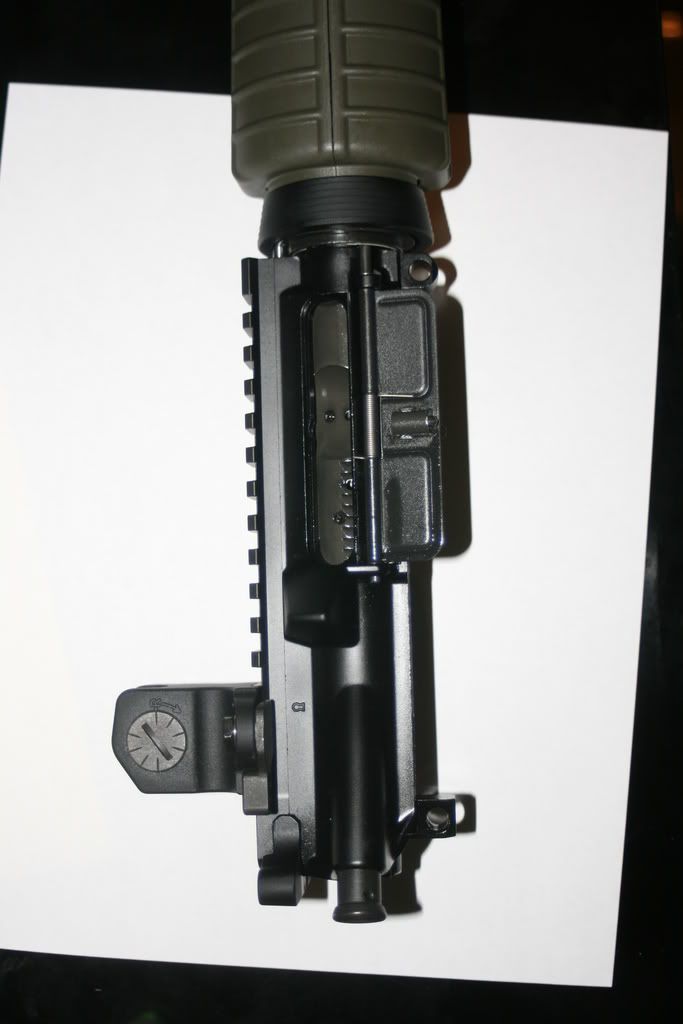

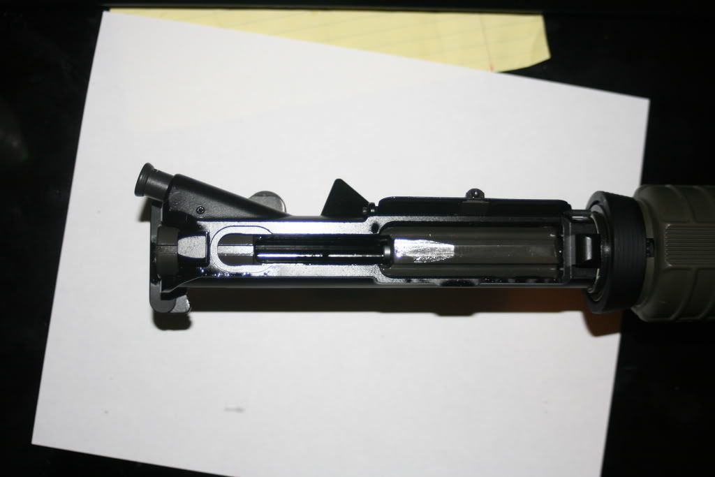

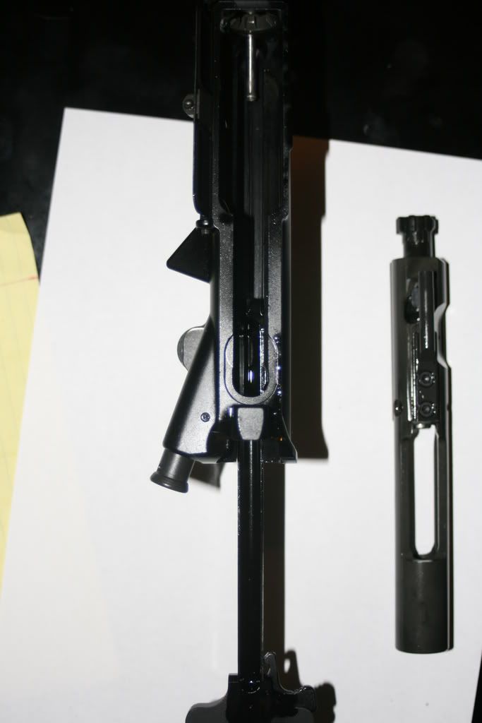

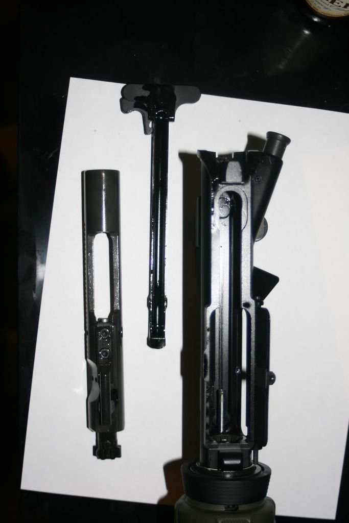

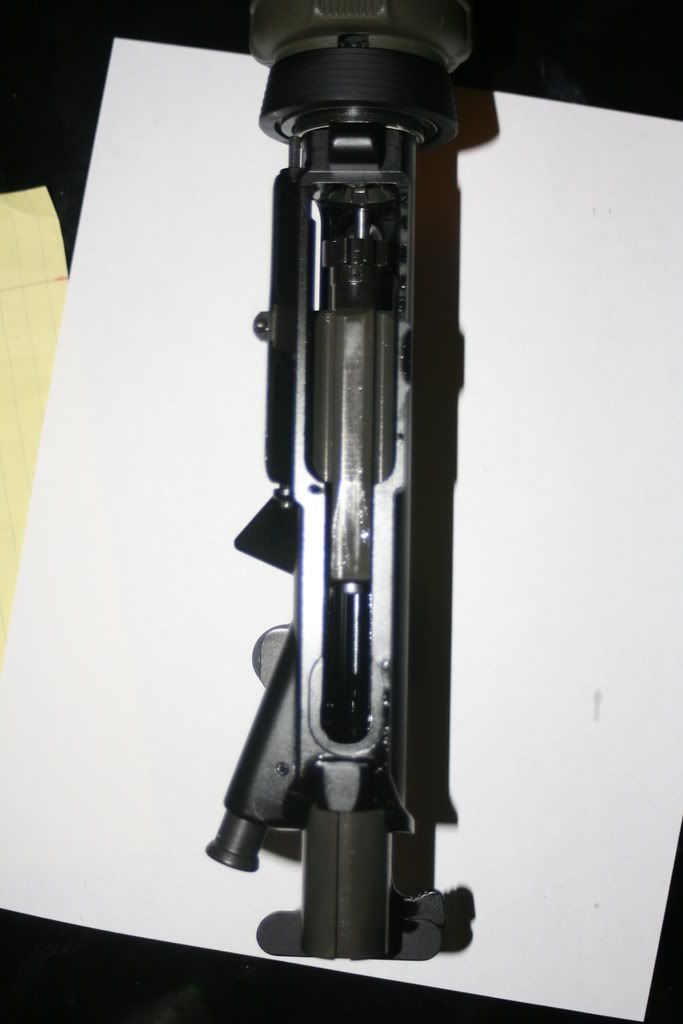

Here's pics (don't mind the excessive CLP, it's been stored for a bit, and I tend to slop it on if it isn't going to be fired for a while)
Upper receiver upside down with Bolt Carrier group (BCG) and charging handle (CH) removed.
Upper receiver upside down with CH inserted partially to allow BCG to be inserted.
Upper receiver upside down with CH and BCG partially inserted.
BCG and CH are pushed further into the upper here.
BCG and CH pushed all the way home (you're hear and feel a very distinct click).
